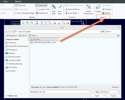

Is it possible to import drawing page creo into a new drawing Creo Parametric but with associativity ?
With the functionnalitie import drawing/data is possible to insert a specific page in my new drawing buth without link
Maybe option or specific application?
Thank you
Best answer by tbraxton
If I understand correctly then no, this is not supported with the import function in drawing mode. When you import a Creo drawing it creates a snapshot of the drawing at the time of import and is not associative with the source drawing after import.
The solution to your scenario is to import the source drawing after it is modified to reflect the latest version of the source drawing.

Yes, this is possible. If you have an existing Creo drawing you can use the import function to import the drawing to another drawing. When you do this, it will create sheets as required in the target drawing.
When you import a Creo drawing you import the entire drawing contents (not formats), not just a single page. If you need a single page, you will need to configure that in a Creo drawing before importing it.
11-Garnet
April 14, 2023
Yes i have tested this solution but without link between 2 drawings

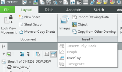

Have you looked at the Overlay function?
11-Garnet
April 15, 2023
Hello
Great!!! I didn't know this function but it corresponds to my need.

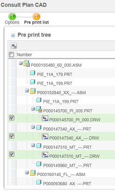

Now i have 2 solutions: Overlay or use consultation functionalities in Windchill.
