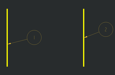

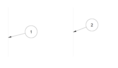

hey guys, I have a similar if not same issue, I just want to confirm that before I go changing everything.
I have a drawing of a dxf file, I change the line style width to 1.000 from 0.000, the line gets wider in the drawing and its what I want but when I print the dxf its really thin just like the rest of the lines.
below is what I want and then what I get after creating a pdf.
thanks in advance
