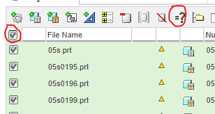

Using edit attributes, you can select all and use the =? button to change all of them at once.
10+ years in Creo/Windchill and I don't think I've ever noticed this button. Hahahahaha.
