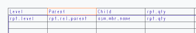

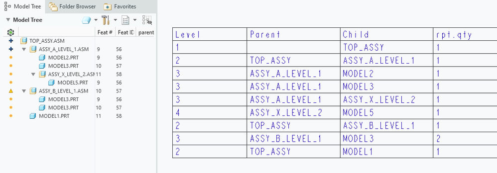

Best answer by RPN
I did it with a Repeat Relation.
As far I see PTC will do a Depth-first search. And this is only one solution I guess..
You must have rpt.level and asm.mbr.name in your repeat region, else you don't have access to the corresponding vars.
The relation will be evaluated not recursively in Creo with a new stack, so the var values will be keept during this while/for Loop.
In Level 1 your Parent is empty "" and you save the name in lev1.
In Level 2 your Parent is lev1 and you save in lev2 the name
In Level 3 your Parent is lev2 and you save in lev3 the name
... and so on
You must have this for the amount of levels you expect.
PARENT is a Repeat Relation Var -> rpt.rel.parent, and must be added.
Here this example stops at Level 4, Level > 4 will set a static text, to force a relation edit.
I kept the relation easy to maintain, no "else"

The example table is attached.

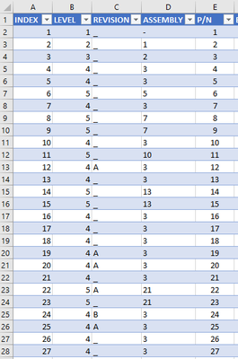

March 10, 2023
Hello, Martin.
Reading your and Ken's answer, I understood that I'll have to export the list without this column and create a macro inside Excel to organize these numbers.
Thanks!
March 10, 2023
Hey.
It was easier than I thought.
I used this formula on column D (ASSEMBLY)
=LOOKUP(2;1/($B$2:B4=(B4-1));$E$2:E4)
Note that I use ";" as separator. Correct to "," if needed.
