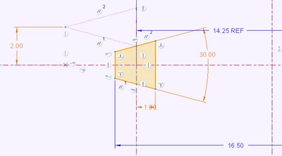

March 26, 2024
yes here's the sketch for the helical sweep. this is what I have drawn, pitch is set at 4mm

Your inquiry is still not clear to me. Do you have a thread specification that you are having difficulty modeling in Creo? Is the issue that you built an accurate model in Creo and are asking why the 3D printed parts are not meshing well? Threads in metal parts are made using processes that generally hold much tighter tolerances than you will get on any 3D printer.
Here is an online calculator for this type of metric trapezoidal thread. Use the calculator (at your own risk) to generate the dimensions for your threads and then check them against your Creo model.
https://www.threadspecification.com/tr/

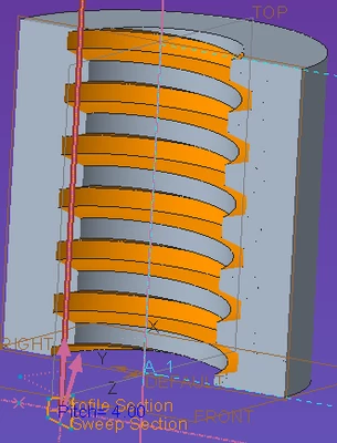

March 27, 2024
I do need more clearance. what should I adjust here?

March 27, 2024
I think this looks like a pitch problem. It looks like your OD and ID is good, so i'm thinking it's not scaling.
But your threads are touching on both opposite sides. To me that is your binding and I'm thinking the pitch is wrong.
Verify your threaded lead screw is the pitch you think it is. I would physically measure threads per inch or whatever it is in metric on both pieces.
