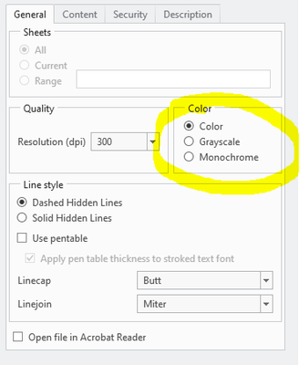

I have nearly what I want without a pen table when I export to pdf (color, use pen table)
my quilts are exporting as yellow and I would prefer them to be black (thin lines)

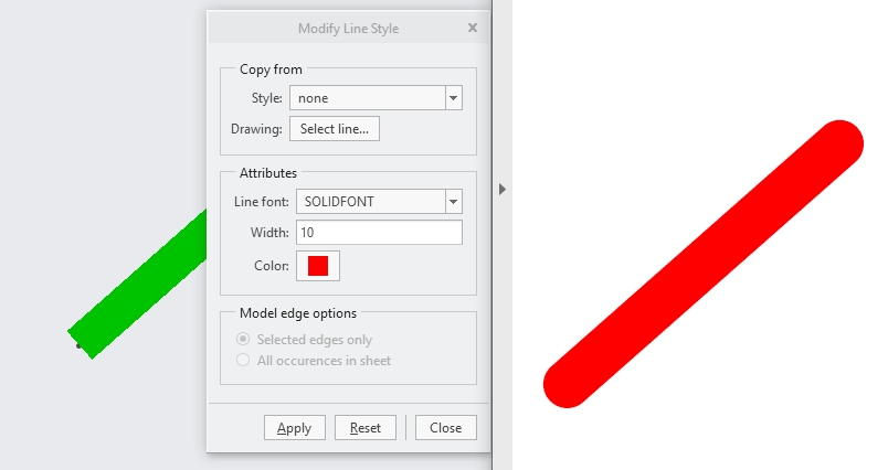

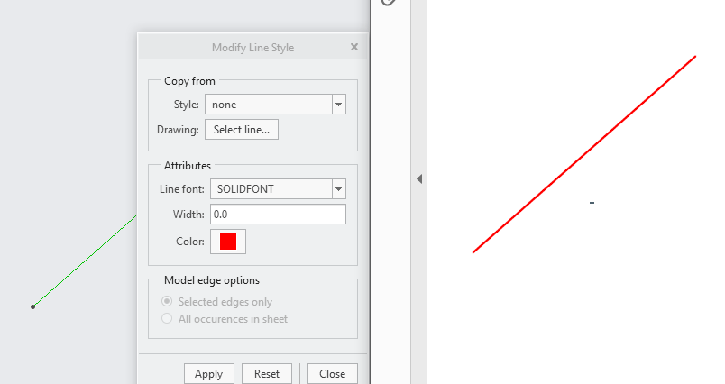

Aug 27, 2023 3:07 PM UTC
One can override colors by not specifying color for pen one as said in the document.
However does anybody know how to make it so that line thickness overrides also get passed to the printer layer as set. Without loosing the possibility to set default line widths.
Aug 28, 2023 6:59 AM UTC
line width set in pen definition always overrides line width set in a drawing.
