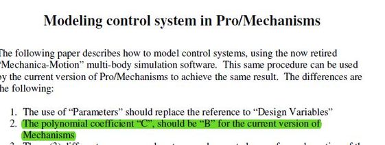

Yes, you can! There was an old example model that PTC posted many years ago when the tool was "Mechanica Applied Motion". I have used this same model to have it run properly in Creo 5...at least it appears to run properly, as I haven't checked the details of all results to know it's accurate. I have attached a PDF of the original paper posted many years ago and my comments on how this should be modified to get the desired result in Creo (even those are old now!). The model is also attached (Creo 2 version).
Enjoy,

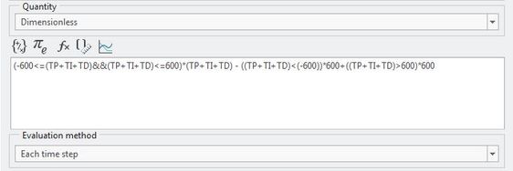

I wonder how one can limit the torque of the motor (in plus and minus).
I worked on your model and I saw that If I add only 1 torque motor, instead of 3, who is commanded by a user defined measure (that is the sum of the measur of the 3 troque motors) I have the same behavior as before.
But if I try to limit this new motor (-600<=total torque<=+600) the system doesn't respond well.
What am I doing wrong?

Did you try adjusting the gains?  Particularly the integral gain should be reduced for a saturated system.
