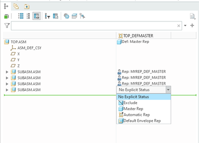

You can use simplified reps but the default needs to be master so the assembly level simulation model gets propagated upward. Change anything that inherits the default exclude to be explicitly excluded, then change the default to master. I am not saying the everything has to be master but that only items that are at master will be included in the model and this includes at the assembly level. This also allows you to not include the assembly simulation model if you do not want it, by setting it to default exclude in whatever simplified rep is active. Just because parts within an assembly are master does not mean that the assembly containing them is set to master. Hopefully this all makes sense to you now. I think they should have had two settings for the assembly, both whether it was master or exclude at the assembly level and whether the default for sub-parts/assemblies would be master or exclude.

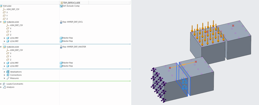

Note in my screenshot how the spring which is in the subassembly model is not present in the model that is set to default = exclude within a user defined simplified rep.

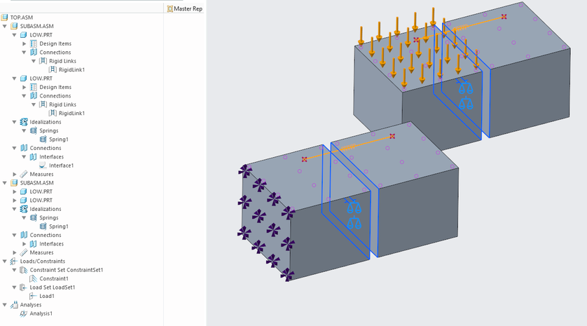

Thank you so much for clarifying! Hierarchical modelling does work in native mode, For example springs and rigids etc all propagate from parts to subassemblies to top level assemblies. If you are using simplified reps make sure the subassembly is set as master (simulate only works with master reps)
For this example the rigids are in the parts, the springs are in the subassemblies and the loads/constraints at the top level.

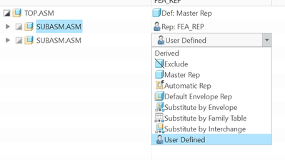

You can choose a simplified rep called "user defined" then select the name of the rep. you saved. For example I use "FEA_REP" so it is clear that the rep is specifically for FEA.
In the subassembly- make a rep. specific for FEA
Then in the level above choose the USER DEFINED and select the FEA_Rep within the lower subassembly.

Thanks. Yes, I was aware of and use this approach often in my assemblies. What I'm not seeing is the simulation features embedded in the subassembly user-defined FEA_rep showing up in the mesh of the top assembly FEA_rep. When I go back to the top assembly and change those subassemblies to master rep, and then go back into the top assembly FEA_rep, I see the subassembly simulation features in their respective FEA_reps (in the footer). Unfortunately, when I change the subassembly reps to master, all the components that I painstakingly excluded from or set as master in the subassembly FEA_reps reappear, and then I have to go back and exclude them in the top assembly FEA_rep one by one. It defeats the purpose of setting up the subassembly FEA_reps if their simulation features don't propagate up to the top-level FEA_rep and I have to redefine them as master. If there are multiple instances of the same subassembly, I have to do this for each subassembly, which, again, defeats the purpose of using user-defined reps. Hope that makes sense.
Your recommendation to use the master rep does work, but I was hoping that these user-defined reps would behave in a similar manner.

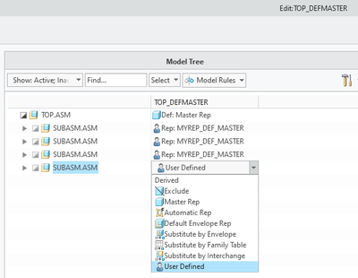

Maybe I am misunderstanding the way you use simplified reps, but I think you only need to correct the subassembly rep to default=master one time in a user defined rep and then reference that predefined user rep within the subassembly for every instance. You should not need to redo all the master/exclude for every instance of the subassembly. Another way to possibly describe this is to not set master/exclude at any level below the immediate assembly - assign the correct user defined rep for any subassemblies and let the subassembly control the master/exclude conditions.
Note how if you modify from the model tree, the user defined option does not show up, as well as all the substitute options.
