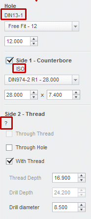

Here is an example:
I add different hole charts to the options.
  • ISO and UNC are Creo Standards
  • DIN13 are custom hole charts.
The result is, that
  • for the Hole the DIN13-1 is used,
  • for the Counterbore the ISO is used and
  • for the Thread no hole chart could be found, because for the selected screw size (M10) there doesn't exist a diameter in the UNC hole chart.
