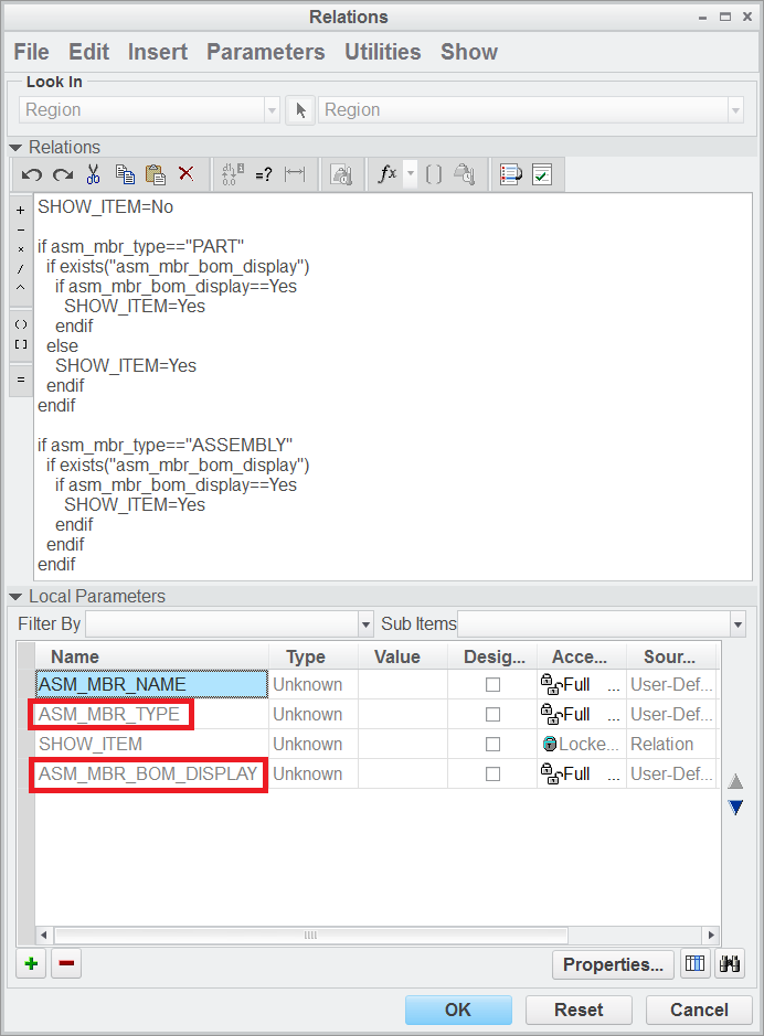

I'd like to use two conditions to filter a repeat region, can I do this?
What I mean is that I want to filter all assemblies out of my region except the ones with the parameter BOM_DISPLAY set to YES.  So, I'd like to display assemblies only if these two conditions are met:
&asm.mbr.type  == ASSEMBLY*
&asm.mbr.bom_display  == yes
But, I believe that if I put those tow things in the repeat region filters the only items I'll get are those assemblies.  I'd like to get all the parts too (except skeletons and parts where BOM_DISPLAY is set to no).
So, what I want is:
&asm.mbr.type  != SKELETON*
&asm.mbr.bom_display  != no
&asm.mbr.type  != ASSEMBLY*
EXCEPT where:
AND:
Of course, that's not going to work.   How can I accomplish all of this?
May 13, 2016 10:33 AM UTC
Doug,
I created test data in CR2 M070 (repeat_region.zip). Unzip it, investigate it and apply it to your real data .
In Relations dialog box I had to create two highlighted parameters manually (as String parameters).
MH

I would suggest using repeat region relations to set a parameter that can be used by the filter to determine whether or not to show each row.  Take a look at this discussion:  REPEAT REGION FILTERS

May 13, 2016 1:50 PM UTC
like this?:
7-Bedrock
May 14, 2016 3:30 AM UTC
Very good~!!!
If the component is not too much
Like this:
Asm create a parameter: bom_display=no
Filter:&asm.mbr.bom_display !=no
This is faster.
