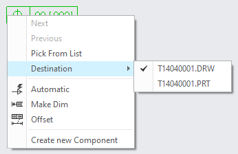

Raphael‌, I am struggling to figure out how to get dual dimensions to show up in GTOLs.  Dual dimensioning is working fine for dimensions but for the life of me I can't figure out how to get them to show up correctly in the GTOL box.  This is working fine in Creo 3.  Thanks.
Creo 3.0
Creo 4.0
By the way, the model is in metric units but the drawing is set to display "Secondary [Primary]".  These settings don't appear to be impacting the GTOL tool.

I am facing the same issue, dual dimensions are working well with the exception of GTOLs, I always get the secondary value in the same unit system as the primary.
Did you solve this somehow? Thanks in advance!

When creating the GTOL, right click and hold and then try changing the destination.
