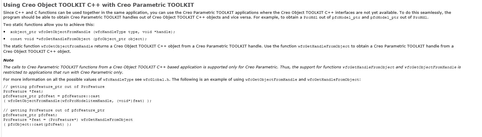

    functionality seems to be missing in OTK C++ API, is there any way to call ProToolKit method in C++ OTK Application?
    FV_01
    FV_0117-PeridotAnswer
    user guide quoteuser guide...
