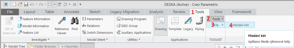

Jan 16, 2018 1:36 PM UTC
your code can find drawing dimensions whose symbol names are add0, add1, and so on.
To be able to create such drawing dimensions you have to set following config.pro option
CREATE_DRAWING_DIMS_ONLY yes
Only these dimensions are saved in drawing - this means drawing is their parent.
Drawing dimensions whose symbol names are ad0, ad1, and so on are saved in drawing model - this means drawing model is their parent.

tekknow1-VisitorAuthor
Jan 24, 2018 9:37 PM UTC
Hi Martin,
Thank you for the code and detailed instructions.  I opened your java code
C:\Users\Greg\Downloads\search_dimensions_CR4_2018-01-20\search_dimensions_CR4\zdrojovy_kod\SDVapp.java
I see you are still using Dimension2D in 2 places,
here:
Dimension2D dim = (Dimension2D)dims.get(i);
here:
and here:
Dimension2D dim = (Dimension2D)drawingShownDimensions.get(i)
If I use that in my code I get error
Exception caught: com.ptc.wfc.Implementation.pfcExceptions$XToolkitObsoleteFunc
You really got it working under Creo4?
Greg
