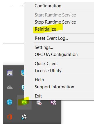

Jan 8, 2019 7:09 AM UTC
Hi @grantji,
You need to right click on KepServerEx icon on bottom right of your machine, you will get reinitialize option there.
Himanshu

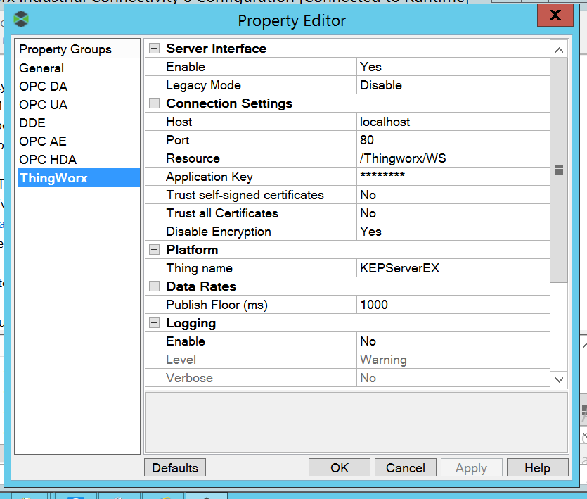

May 16, 2019 11:38 AM UTC
Hi Himanshu,
I just installed both Industrial connectivity(8.4.66) and Thingworx foundation trial(8.4). Getting the same error as discussed in this thread. I have attached both my Thingworx instance and property of IC.
Raj
hchanana16-PearlAnswer
May 16, 2019 12:00 PM UTC
Hi @RV_7 ,
Can you set Disable Encryption to yes and try to connect.
If this does not work, additionally change localhost to 127.0.0.1 in the host property.
Himanshu
