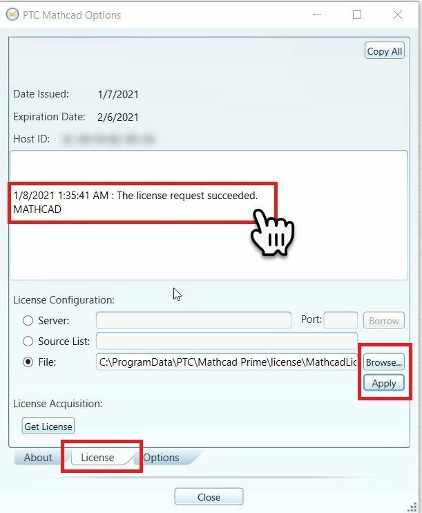

I have MathCAD PTC 7.0.0.0 (already installed)
I have a license file  (already generated)
How do I connect MathCAD to that license file?
Other software that I use usually has some type of built in license management - so, in those scenarios, you open the application and then point that application to that license file.
Please respond
Best answer by VladimirN
Browse your license file on "PTC Mathcad Options" window (tab "License"): https://community.ptc.com/t5/Mathcad-Installation/How-to-Acquire-Mathcad-Prime-30-days-License-for-Mathcad-Prime/m-p/706367#M15

That worked.  Thank you.
