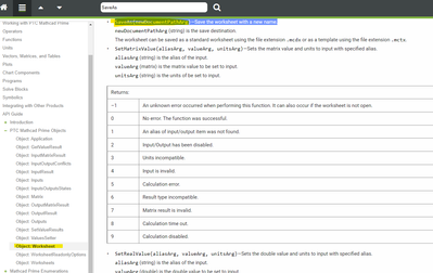

Hi A0
I think that you need to be more specific about what the error is and also try to narrow down where the error occurs, as you have posted a very long piece of code. The Mathcad Prime API documentation apparently doesn't have a PrintAll method, but you can use the SaveAs method of the worksheet object, and include ".pdf" in the file name to be saved, see below snapshot. I have done this with success.
