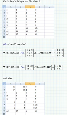

WRITEEXCEL writes data to an excel file. If it doesn't exist, it creates it. If it exists, it overwrites existing data.
Some remarks:
- It doesn't seem to be able to create new sheets in the Excel workbook, you're limited to 3 sheets when the file is created by Prime.
- the function of the arguments 'rows' and 'cols' is unclear.

I gave this a try before considering VBA. The thing is that the "WRITEEXCEL" function can only write data to a new file, which also only seems te be active for a specific Mathcad worksheet right? This would not be possible for me since I need to export data I calculated to an existing Excel file of my client.
Some remarks:
Thanks for the reply! I did not know this function could overwrite existing data, so this could be an outcome.
Mathcad is able to read my existing Excel file, but when i want to overwrite data using the WRITEEXCEL function i get the error: a call target threw an exception. The problem seems to be the matrix. Did I do something wrong here?
The file must NOT be open (in use) by Excel itself at the same time.
As said, I don't understand the function of the parameters cols and rows (the two ones) in the function call, is not described in the info about WriteExcel. What happens if you leave that out?

The problem was caused because my Excel is set to Dutch. "Sheet1!" apparently had to be replaced by "Sheet1!". Now it is possible to write the data to an existing file.
