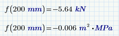

Hi Werner_E!
Thanks for your support.
1) In our earlier discussions, if you remember, this graph was polted by you for without unit for the block_solve. Why function ordinate is defined with double "xx" as f(xx) and abscissa with double "xx".
and when a function is defined for a root, it has a single x as f(x).
2) Why is unit defined as (m2.MPa) for plot f(xx)?
Please refer to the attached image.
Thanks and regards
MSRAZA
Unit can change to N.
Because your function f returns force values.
A more natural unit would have been kN (as seen in Alans file and screenshot), but you already had put "MPa" in the unit placeholder and Prime adds m^2 so that we again get a correct force unit.
The result of a function is either determined by an explicit return statement or by the last expression of the program. In your case thats the last line of the program. Here you are multiplying pressure values (f.ck, f.st) by areas (b*x, A.sc, A.st) an so you get a force which can be given in Newton but also could be written by m^2*MPa. If you demand MPa, Prime would add the default area unit which is m^2.
Did you expect a different unit here? If you expected a pressure value here then you would have to correct the expression in function f.
If you expected kN then you simply have to write kN in the unit placeholder of the ordinate axis as seen in the plot above and also in Alans response..
