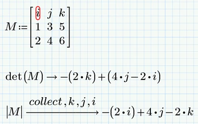

How to get determinant values for matrix in the terms unit vectors along the x-axis, y-axis and z-axis respectively i.e i,j,k
Best answer by Werner_E
Always attach your worksheet if ever possible.
As i, j and k seem to be undefined, you have to use symbolic evaluation:
Werner_E25-Diamond IAnswer
December 12, 2022
