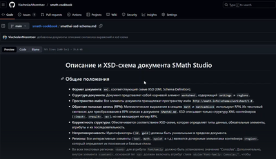

uni
(To:StuartBruff)
It is possible and can be done in the following way: https://rutube.ru/video/70d4f544a506b57edc3939be1233a756/
StuartBruff
(To:uni)
Прикольно, Вячеслав!
I look forward to your Mathcad Prime video of the same.  😈
Stuart
uni
(To:StuartBruff)
There are many of you, and I am alone. The direction you showed will lead to a practical result. I have already implemented this, but I am not interested in Mathcad in this regard, since I do not use it.
I just wanted to support you. It is much easier to move forward when you already know that success is achievable.
You need a propmt engineer. There is such a profession now. He needs to develop a methodology for interacting with AI. The method that I use is not simple. And you can throw chatgpt in the trash if you want to go this way.
In my implementation, I myself am the developer of some of the system components, so I know the details of the document format implementation. In your case, you need to beg for such details from PTC or study the document format. Why should I do this? You have a lot of people here.
If you want to have a full generation of a Mathcad document, you will find a way.
