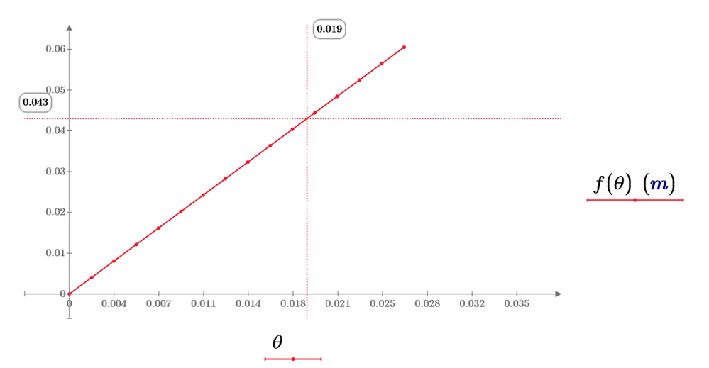

how can i find out x intercept of a certain value of y intercept as shown in below sheet.

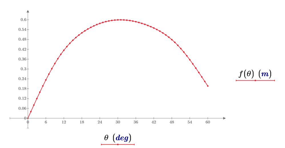

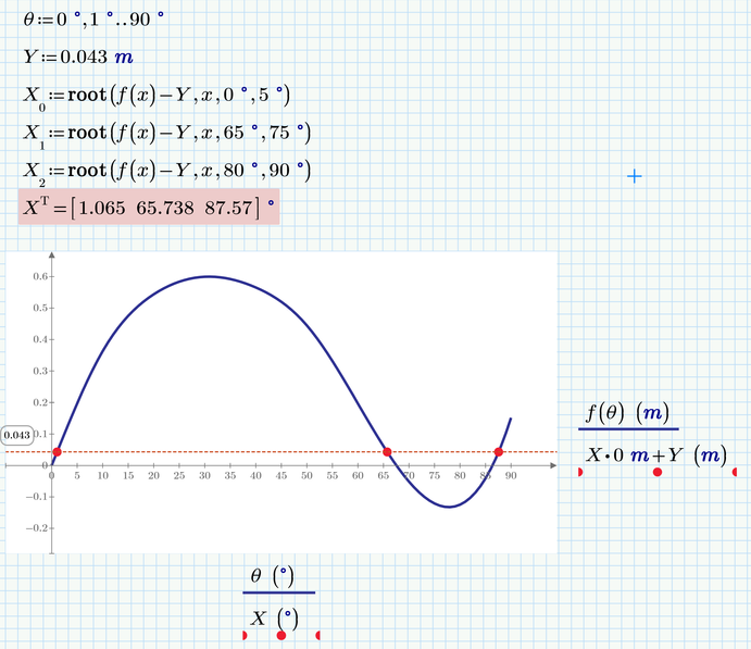

There are two more solutions larger than 60° in case you are interested
Remark: The extra solutions (especially the third one) are "created" by the usage of the spline interpolation (better: extrapolation in this case).
