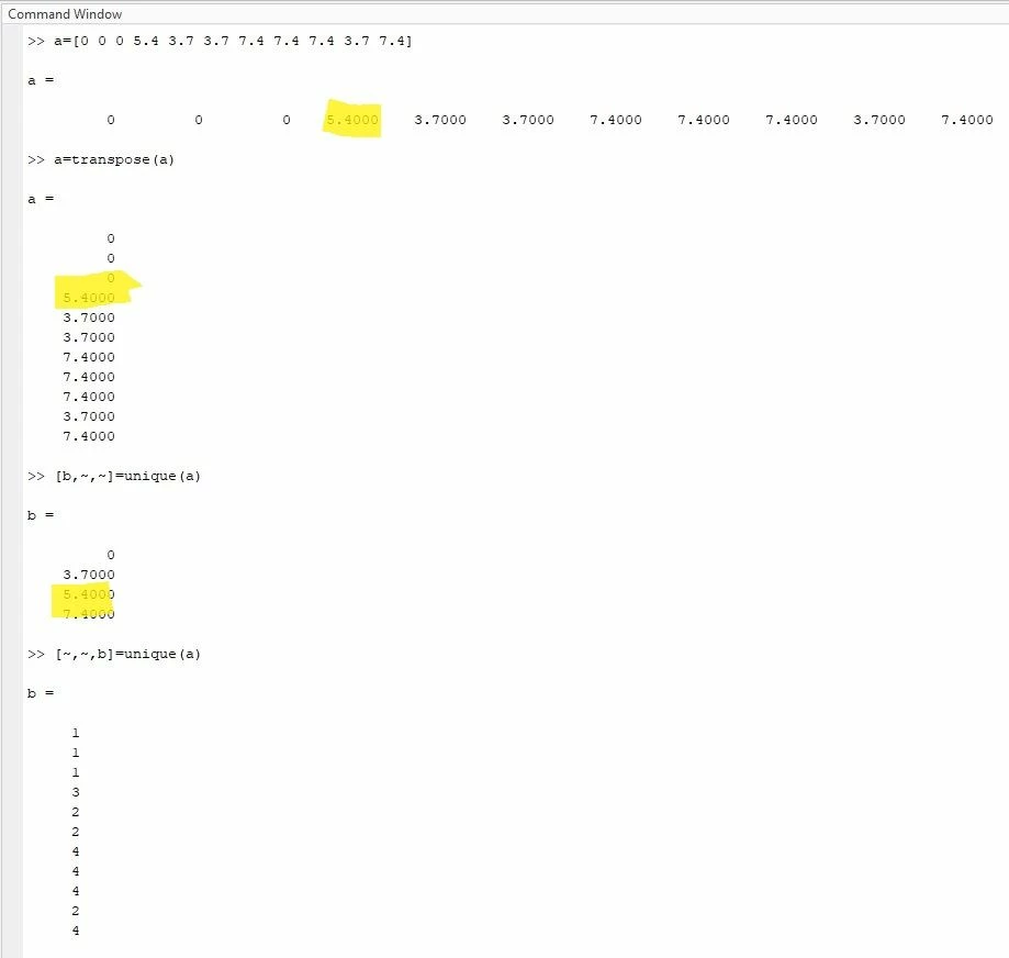

Please, what would be the code that I should do, [~,~,CG(:,1)=unique(Y), the unique function was clear to me. I appreciate the answer, now the expression [~,~,CG(:,1)] It seems that it changes the ordered values from 1 onwards, it seems that all the similar values are changed by a number in repeated order as shown in the figure, in the figure there is also the value of ans, which is unique, and above the value of Y=[0,, 0, 0, 3.7, 3.7, 3.7, 7.4, 7.4, 7.4, 3.7, 7.4], using puts it in the first column as [1, 1, 1 ,2, 2, 2, 3 , 3, 3, 2,3], how would that programming be, in Mathcad prime

Best answer by terryhendicott
Hi
Matlab "unique" function sorts the terms in increasing order.in the result.  I have added a 5.4 out of order to show you.
In order to get this need to add some sorting in the Prime function:
Cheers
Terry
