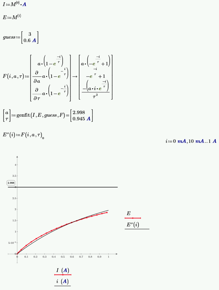

Hi.
First post, LONG time mathcad user...on prime 9 now.
I'm trying to fit a fairly routine function to some datapoints using genfit.
I don't see where this is going wrong.
genfit basically treats the guess value for 'a' as a hard constraint.
So whatever I set the guess value to ('3', below), the fitted function asymtotes to that value and does not adjust 'a' to fit fit the data.
What am I doing wrong?
Many thanks in advance.

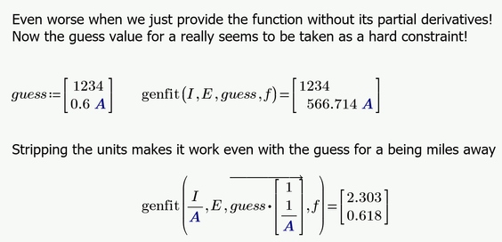

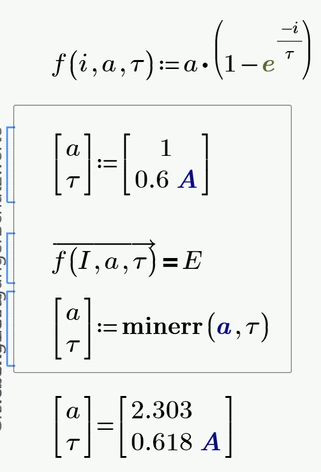

BTW, as an alternative to "genfit" you can also use a solve block with "minerr". Here the units seem to be no problem:

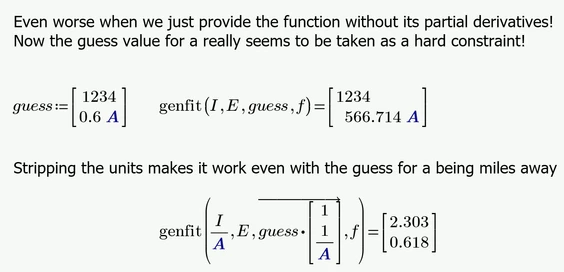

I also noticed that the bug you found is even more evident if we don't provide the partial derivatives. Now the guess for "a" really seems to be taken as a hard constraint and the value is not changed all:

Its too hard to debug a picture!
Please post your sheet with the data.
Maybe Prime is right!? Your fitting function just depends on two parameters. Maybe 2.998 actually IS the optimal value for the scaling parameter a ?!

Could it be that your function has local optimums around any value of a? And then those are found.

I searched the forum and found, that I discussed what seems to be the very same bug already 10 years ago with Richard. Had completely forgotten about it.
Bug in Prime 3 using regressions with units? - PTC Community
Perhaps some kind soul (? @DJNewman  ?)  could report this bug in a way that makes it likely to get fixed as soon as possible.
DJNewman
February 29, 2024
Documentation actually does make reference to genfit not accepting units. ...It's not on the genfit page, and I don't know why, but it's on this page instead:
https://support.ptc.com/help/mathcad/r9.0/en/index.html#page/PTC_Mathcad_Help/expression_type_functions.html
So perhaps it's not a bug and a documentation issue, in which case, feel free to click the "Send feedback about this page to PTC" button to email the Documentation team directly.
PTC Marketer for Creo and Mathcad. I run their YouTube channels, some Creo campaigns, and all Mathcad campaigns and communications.
February 29, 2024
Thanks for the information. Its well hidden, indeed. BTW, The page says that the ODE solvers won't accept units but I thought that they would be unit aware now!? Or does this apply to the solve block "odesolve" only and the stand-alone solvers still won't accept units. Have to give it a try sometime.
So its sure a documentation  issue which should be fixed,
But I still consider it a software bug, too. If a function is not intended for unit-based input values, then it should output an appropriate error message if you feed it with units anyway and not return an incorrect(!) result without comment - that is quite dangerous and an absolute no-go IMHO.
This means that we need two bug fixes in the short term:
1) The documentation must clearly emphasize in the description of the function the fact that units may not be used.
2) The function itself must recognize input variables containing units and output a corresponding error message and must under no circumstances simply deliver incorrect results.
