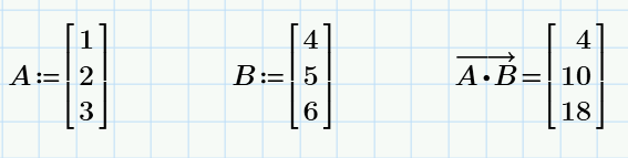

how to do element product in two column vectors?
In mathCAD prime 10,
For example,
A := [1 2 3]
B :=[4 5 6]
I want to have C=[4 10 18]. In this case, how can I express it in mathCAD?
Please help me!
Werner_EAnswer
Jun 14, 2024 5:39 AM UTC

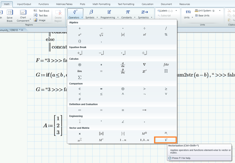

You have to use "vectorization"!
Prime 10 file attached

Werner_E25-Diamond IAnswer

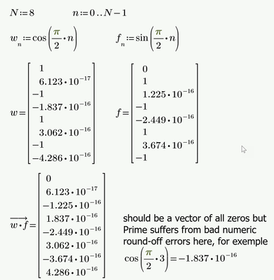

Jun 14, 2024 6:09 AM UTC
Thanks a lot!
but I have another issue.
Here is my worksheet.
N:= 50     n := 0..N-1
w(s) := cos(2*pi*n)
f0(s) :=sin(10*n)
I need to do element product here.
Vectorizing f0(s)*w(s) doesn't work.
Jun 14, 2024 2:25 PM UTC

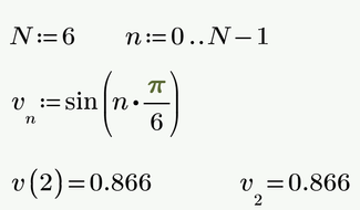

Not sure if the problem is already solve for you. Just to be on the safe side:

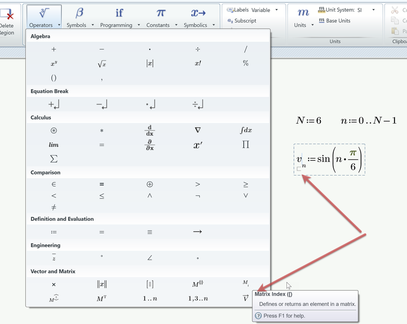

To create a vector you have to use the matrix index. You will notice a small rectangle when you are editing the expression.
You can't use the literal index to do so
The syntax v(..) can only be used to access vector elements, not to create a vector
I for myself dislike this way to access vector elements an prefer the second way shown in the picture using the matrix index.
The reason I dislike it is because the syntax with the parentheses is used for functions.

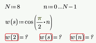

When you defined something like
you defined a function with the formal argument "n". This n at this moment has nothing to do with the range "n" you defined before. You could have used any name.
You also can evaluate the function for any argument you like
And now the trap you felt in. When you write
you are actually dealing with an invalid object. Unfortunately Prime allows it to be displayed and it looks like a vector. Bit its neither a vector nor a range - its invalid.
You can see that if you try to assign it a variable:
You get an error and this also is the case when you try to use this expression in other calculations.

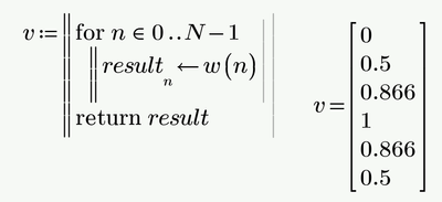

To create a true vector you can use the method described above, but you also could use that function w very similar to the failing expression:
You may think of a range as an implicit loop. Here n is uses as matrix index on the left hand side and so it loops through its values an that way creates a true vector. Behind the scenes a loop is calculated similar to the explicit loop here:
But you are not alone - many users find it difficult to distinguish between ranges and vectors and to use ranges correctly 😉
