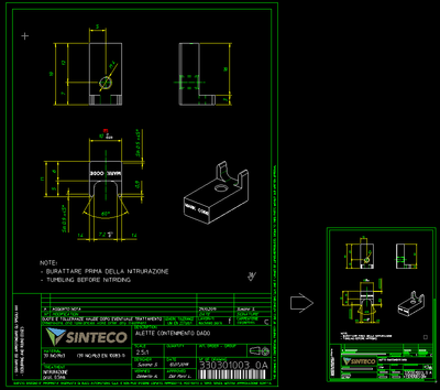

convert to .dwg scale 1:1
I need convert .mi file to .dwg scale 1:1, because in annotation the views are scaled and I need convert the drawing in dwg real dimension.
Can someone help me?
Thank you.
Stefano
ssusana6-ContributorAuthor
6-Contributor
can someone help me?
thank you.
Stefano S.

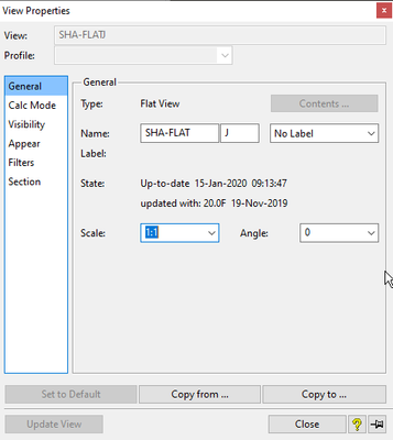

According to PTC, convert the views to 1:1 scale before exporting.
https://www.ptc.com/en/support/article?n=CS54595&language=en&posno=1&q=dwg%20export%20scale&ProductFamily=CoCreate%20%26%20Creo%20Elements%2FDirect&source=search
I hope this helps.
Tom
Change it manually view the view properties dialog...
Automating this with the integration kit is also doable. Either way gets complicated if you use a border.
