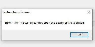

Error: -110 The system cannot open the device or file specified while installing Creo Trial version

Issue:
"Error:  -110 The system cannot open the device or file specified" while installing Creo Trial version
 Reasons/Causes: -
  • The Installation “PTC Creo Parametric 8.0.0.0 Trial CloudPlay.exe” file does not exist.

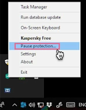

  • Antivirus software is preventing the file from being installed.
Solutions: -
  • Disable any security software on your computer and run the installer again as administrator (Refer below Image)
