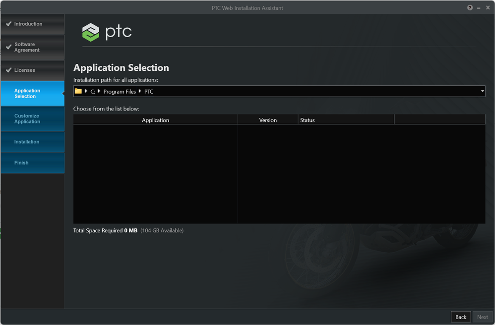

"Application Selection" screen shows no options for installing Creo 10 University Edition
  • June 26, 2023
  • 2 replies
  • 3026 views
I paid for the license and I have my license key and the license pack. The installation seems to accept these as valid, but then when I go to the "application selection" screen there are no options to install the software. So, I'm pretty much stuck like chuck. What should I do?
Screenshot 2023-06-25 211615.png.
Best answer by Alex_Cazacu
Hi Herrera,
Here is a direct download link for Creo 10.0:
https://apps.ptc.com/schools/MED-100WIN-CD-470_10-0-0-0_Win64.zip
~Alex

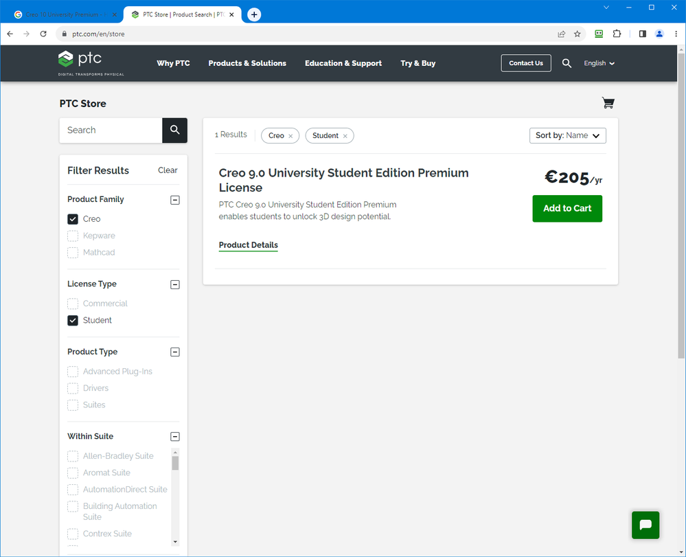

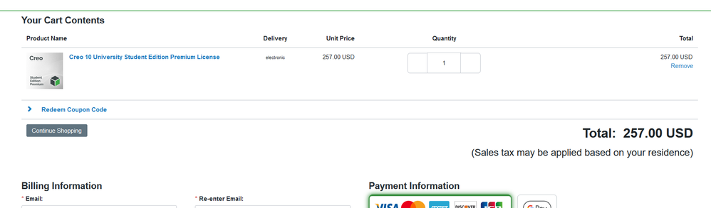

herrera3-NewcomerAuthor
3-Newcomer
June 26, 2023
Thanks for clarifying that for me. Is this a different version of Creo than the University Premium version? On the purchase page it shows that I bought Creo 10 University Premium, but this page only shows up to Creo 9. I believe the free education version of Creo has more restrictions than University Premium, so I just want to be sure that I am downloading the correct software.
June 26, 2023
do not use web installer. Download 5GB zip file from, unzip it into empty directory a run setup.exe.
If the application list is empty again, then your license file does not contain any license code.
