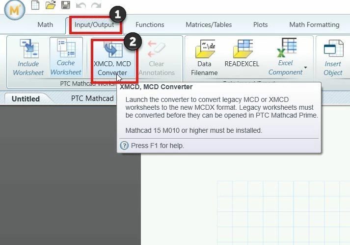

Steps to convert legacy Mathcad worksheets to Mathcad Prime:
1. Start XMCD, MCD converter
  • Mathcad Prime > Input/Output > XMCD, MCD Converter
              Alternative:
  • Start > All Programs > Mathcad > Mathcad Prime XMCD, MCD Converter
  • <Mathcad_Prime_Install_Dir>\WorkSheetConverter.exe
2. Select Add Worksheet > Select the desired worksheet/s to convert > Convert
