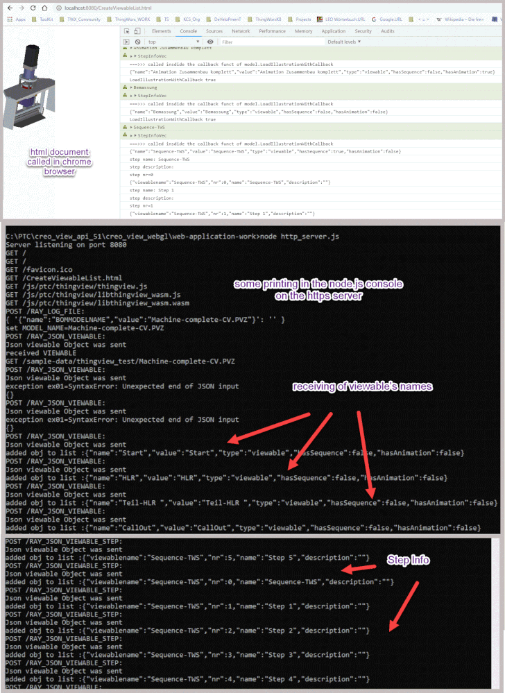

When the Creo View WegGl program is started (load  the html file from the http server)  - So on the server side - in the node.js console  we can see the printing of the received data - example on the picture below:
The Creo View WebGl program will create on the server side  2 json files (this requires also handling of the received  data on the server side as allready mention in the post [1.]  )

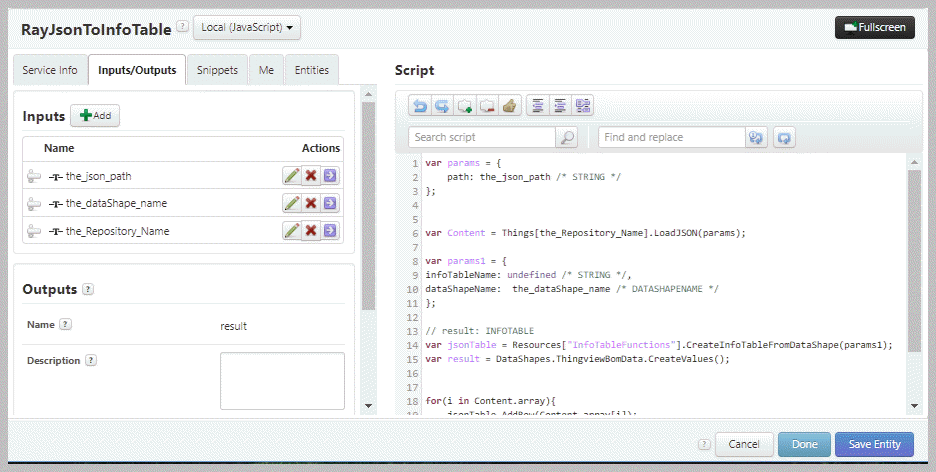

2.) Definition of a service in Thingworx for the Sequence Step List (see also "Service for creating of Bom - and Viewable Lists from json files [3]  )
Here the first Step is to define a general service which will will convert the JSON file to an InfoTable using particular dataShape.  The json file will be taken from a Repositroy  repository
var params = {
	path: the_json_path /* STRING */
var Content = Things[the_Repository_Name].LoadJSON(params);
var params1 = {
infoTableName: undefined /* STRING */,
dataShapeName: the_dataShape_name /* DATASHAPENAME */
// result: INFOTABLE
var jsonTable = Resources["InfoTableFunctions"].CreateInfoTableFromDataShape(params1);
var result = DataShapes.ThingviewBomData.CreateValues();
for(i in Content.array){
 jsonTable.AddRow(Content.array[i]);
result = jsonTable; //returns the InfoTable
The service has 3 Input parameters : the_json_path, the_dataShape_name and the_Repository_Name (all are String type)

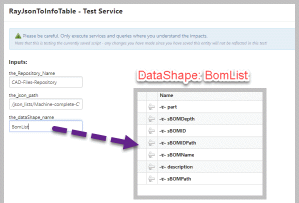

so this service could be called for any file repository, containing any json files(it is not file specific) . Via the dataShape name we will specify the filed definitions.  We need to do this  for each specific json file. In this case we have first manually to  create a DataShape which is compatible to the Json Object.  For example when we start the service RayJsonToInfoTable:
And the dataShape what we need to define in this particular example:

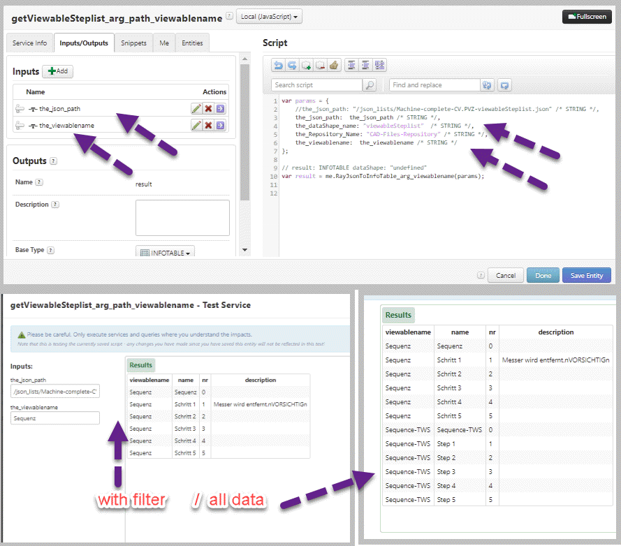

For the achieving  of the final goal -> the creation of the  Sequence Step List. We need to create a  another service where we can specify the arguments for DataShape and  repository name. Example:
So the input argumets are:  1.) the path to the json file and 2.) the name of the sequence for which we want to see the steps.

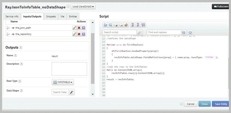

In the mean time , I found a solution  how to read a JSON file  and to convert it to a INFO table without explicit DataShape defintion. The service definition is similar to the described service in the post.
This service has to input arguments 1.) for the JSON file path (the location of the repository where it is saved) and 2.) for the repository name - so means we can call from any repository. The output is an INFOTable but without a DataShape defintion.
The clue in here is to define the dataShape dynamicaly when we read the json File.
So the converting process is implmented in 2 loops
->>one loop for the dataShape defintion and the second loop for the reading of the different rows. Here the JavaScript code:
//var my_data_shape= "fields_dataShape";
var params = {
	path:the_json_path /* STRING */
//create an json Object array
var ContentJSON = Things[the_repository].LoadJSON(params);
//get the first row for the dataShape defintion
var FirstRowJson =ContentJSON.array[0];
//create an empty InfoTable
var resInfoTable = { dataShape: { fieldDefinitions : {} }, rows: [] };
//defines the dataShape
for(var prop in FirstRowJson)
 if(FirstRowJson.hasOwnProperty(prop))
 resInfoTable.dataShape.fieldDefinitions[prop] = { name:prop, baseType: 'STRING' };
//add the rows to the InfoTables
for(i in ContentJSON.array){
 resInfoTable.rows[i]=ContentJSON.array[i];
result = resInfoTable;

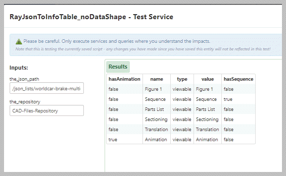

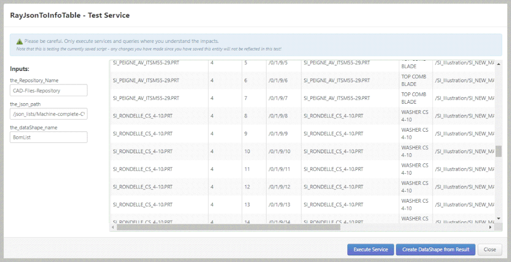

And here an example for the results of the service call:
