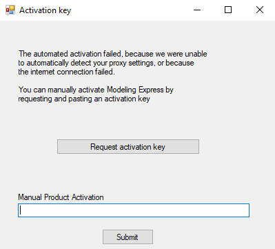

Can't use Creo Elements Direct Modeling Express: Activation Key server down
Unfortunately, this was never fixed.  Now, the Activation Key server is down (URL).
Is Creo Elements Direct Modeling Express still a usable product?  If so, what's the fix?

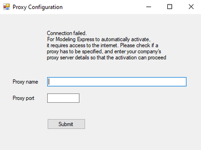

der_Wolfgang
Oct 17, 2025 4:40 PM UTC
This is wrong IMHO!  The proxy /server problem got fixed by releasing Creo Elements/Direct Modeling Express 9.0 in ~ May 2025. It was totally working fine for a bunch of months now.
see https://community.ptc.com/t5/Modeling/Does-Creo-Direct-Modeling-Express-8-0-run-on-Windows-11/m-p/1029474/highlight/true#M1341 for more details on PE90!
The today's problem is that the 'generate activation key' page on the PTC server is not reachable:
with the detailed message "www-cf.ptc.com | 500: Internal server error"

Oct 19, 2025 2:04 PM UTC
Getting the same error: Internal Server Error from Cloudflare (error code 500). Just installed v9.0 and I still get this error. When will this be fixed?

7-Bedrock
Oct 22, 2025 6:24 AM UTC
Hi all,
I manage to solve this issue.
I uninstall all my direct modeling express in my computer.
I download the latest version 9.0 and install.
Problem solved.
***You MUST uninstall first. before installing 9.0.
