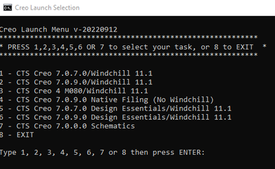

Another option is to use a command/batch file for launching Creo where the users can select which license to use for that session of Creo. This is the option I use. It also allows me to control things like drawing templates and which Windchill system to use. (I had 2 Windchill systems utilizing a common network installation of Creo.)

How can you set up the command/batch file for launching Creo? I have it to where it is a single PSF file which makes sense on how it works.

The scripting is pretty easy if you understand it.
What is your need for using different Creo licenses? If it is only a limitation of licenses, then the single PSF file should do what you need. If you need to control who uses which license, this can be done from the menu script, from a dedicated icon on the user desktop to the right parametric batch file which calls the right PSF or you can control license reservation in an option file of the FlexLM licensing tool.
I was able to figure out the customize feature for here and add the start up option. Thanks for the assistants!
The Creo launch command listing
I now use it for different builds of Creo 7.
