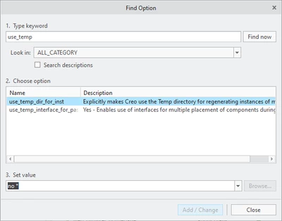

2) in the suggested technique for improving retrieval performance article I can find config.pro and the value Trail_Dir but I cannot find the value Use_tem_dire_for_isnt to alter it to yes. Please advise.

That value may not be in any config.pro file directly. There is a system file that loads the default config options that it may be in. Open Creo and go to File Options, Configuration. This will open the configuration editor. Select Find and then enter the option you are looking for. This will display the system default setting for that option.

The option you need to alter is this one.
use_temp_dir_for_inst
