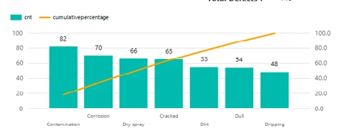

Is it possible to use both bar and line graph in a single chart? Are there any widgets available? I have two data source which one i wanted to be bar and another as line. I have attached an image for reference.

The Label Chart widget can plot bar chars and line charts at the same time as far as I know.

As far as I am aware, no widget exist to display this out of the box as described.
However you can add this as a Thingworx Idea if you think this is a common use case.
I can't think right now of a easy workaround, but it might be possible to achieve this using javascript and plotting it using third party libraries on a webpage which is then displayed through a web frame.

Thank you so much CarlesColl, It helped and I did it.
