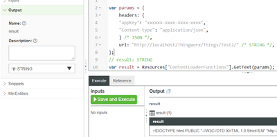

var propertiesAttr = Resources["ContentLoaderFunctions"].GetText(params);

GetText is working for me on 9.1, refer below screenshot,
Would you be able to the code you are using?

Here I am using url path is outside of thingworx server. When I give the url path is inside thingworx, its working correctly and also if I use GetJSON with outside server url path, working correctly. Observation with GetText service with outside server url path. Refer the below snippet which I am using for GetText.

Are you not getting any output or are you getting an error? If it's the latter, please share the error message.
