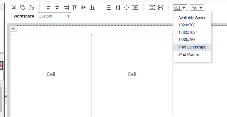

Critical Issue ! Collection widget CANNOT scroll in Android Pad+ Chrome
I have mashup which uses Collection widget to display multiple inner mashups.  I just found the page cannot scroll in Android Pad + Chrome.   In the development mode there is a toolbar on top of the screen which allows you to adjust the screen size,  the responsive mashup cannot scroll if it's "Full Screen", it can only works if set it to others like "iPad Landscape".   In the production mode, there is no such toolbar , I've set the screen size to "iPad Landscape" in Thingworx composer , but it doesn't work.  It seems that the page always act as "full screen" size.
