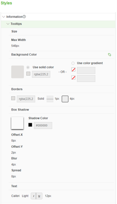

I couldn't find this element for the grid, however I did find the section in the StyleTheme:
There is no text color option for this though... Perhaps it is located someplace else?
I have tested this in some of our other environments and there they work correctly (the text is visible in the tooltips).
So I am guessing this has something to do with my company's Style Theme.
I will report it to the developers and hopefully get the newest version of it into my platform.
Thank you so much for your help!

Do you use the same color for some label/text variance (title, header, body etc) as for the tooltip background? Because the settings in the StyleTheme often  complement each other. So the used text color for the tooltips could be the one set for the "Body" labels.
jensc
(To:DanZ)
Yeah, I think that is it although I couldn't quite see which text color it could've been.
Thank you for you help though! I didn't even think to check the style theme.
