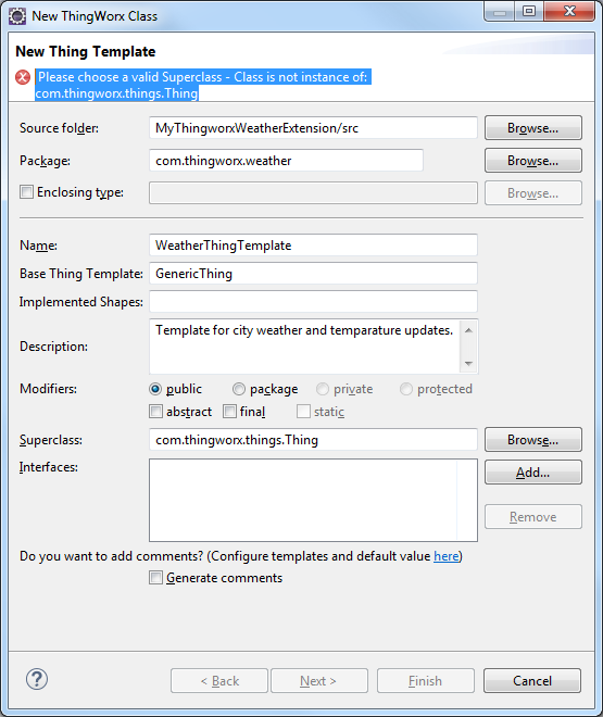

Error while creating new thing template
I am trying to create new extension. I have installed the eclipse plugin for sdk, however, while creating new thing template it shows me following error.
 Please choose a valid Superclass - Class is not instance of: com.thingworx.things.Thing
Any idea what's wrong here?

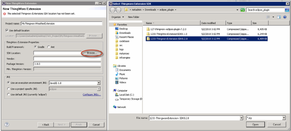

Hi @Shivaji,
You can include SDK zip while creating project itself. Refer attached screen capture. Make sure you don't extract the SDK zip.SDK_in_Eclipse_project.png

Sep 10, 2018 9:01 AM UTC
After including Jar files this error does not show up.
What is the best way to include SDK zip file to eclipse?
