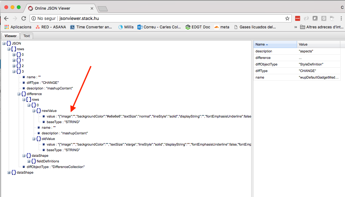

Digging a bit with the services, if you use GetDifferencesAsJSON service you can get difference styling between a base style and the given one, you get something like this where you can get the styling, crappy but it can work:
Sorry it's the old value, your code should look something like this:
// -- where styleName contains the Style Name for which you want to recover style content
var data =  StyleDefinitions[styleName].GetDifferencesAsJSON({ otherEntity:"DefaultMashupStyle" });
var result =data.rows[data.rows.length-1].difference.rows[0].oldValue.value;
