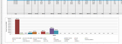

please refer the following screenshots, I want this kind of result :
Best answer by Sathishkumar_C
Use "Excel Report Template" which will have predefined graphs. You just populate data to template file after saving as a new file.
Graphs will be populated automatically.

December 17, 2021
