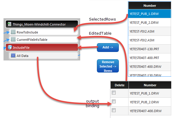

I would like one button to add rows to a grid widget and another button to remove rows, not sure how to accomplish this
I have two grid widgets on my screen, and I have successfully configured a button to call a service that adds any selected rows from grid # 1 to grid # 2 using Resources["InfoTableFunctions"].Union between two infotable inputs - one being the selected rows data from grid # 1 and the other being the editedtable all data of grid # 2. The output infotable from that service is bound to grid # 2.

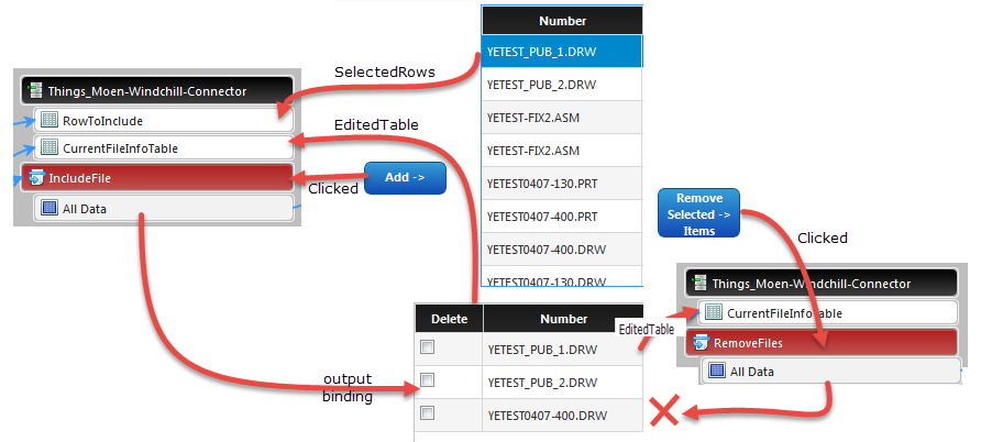

I wanted another button that would remove rows from grid # 2 if they checked an editable checkbox in the rows. I wrote another service that can iterate the rows and remove any that have the checkbox checked, but I can't bind the output of THAT service to grid # 2 since it is already bound to the output of the first service.
Any suggestions?

I had this kind of situation several times when I want to bind many sources of data to the widget. In your case, here's what I can think about:
- Create a Thing like Helper.Mashup which contains a String property "SOURCE_DATA"
- Create a service somewhere which has 2 inputs Infotable "dataInclude" and "dataRemove" with the same DataShape as the one of data result (for grid #2). This service returns also an Infotable of the same DataShape.
- Bind 2 results All Data of the 2 services IncludeFile and RemoveFiles to the 2 inputs of the service above. Bind the result to the grid #2
- In your service IncludeFile, add: Things[Helper.Mashup].SOURCE_DATA = "INCLUDE"
- In your service RemoveFile, add: hings[Helper.Mashup].SOURCE_DATA = "REMOVE"
Now you can imagine that I try to use the property SOURCE_DATA to identify where is the data come from in order to return it to the grid #2. So, some more steps:
- In the new service, add a check: if (Things[Helper.Mashup].SOURCE_DATA = "INCLUDE") {var result = dataInclude} else {var result = dataRemove}
- Bind two events ServiceInvoked of two services IncludeFile and RemoveFile to this new service.
What do you think about this work-around ?

yevans1-VisitorAuthor
Jun 22, 2016 1:09 PM UTC
Yes, that works very well! I was trying to go down a similar path - if you use pure JS in a web app and define a click event on an HTML element like a button, in the function called by the event you could query the source of the event with something like event.target.id to determine which button was pushed. I could not figure out how to do that in a mashup, so your solution basically achieves the same effect.
I just defined a variable as a property on the thing where all my services are - so I basically have three services:
includeFile:
me.sourceData = "include";
removeFile:
me.sourceData = "remove";
updateTable:
if (me.sourceData === "include) {
  <add selected rows of grid # 1 to grid # 2>
} else if (me.sourceData === "remove") {
  <remove checked rows from grid # 2>
I only need to bind the two tables as inputs to the third service, the first two services have no inputs or outputs. I just bound the serviceInvokeCompleted event for both of them to the third service.
Thanks for your help, I've been trying to figure this out for a week!
