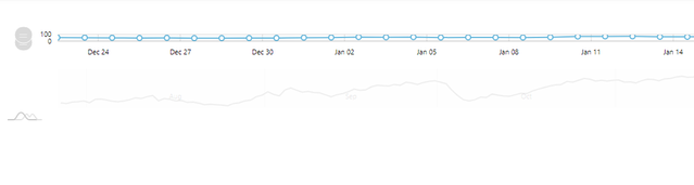

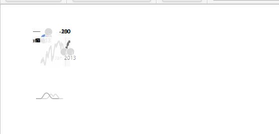

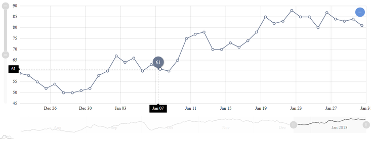

I tried creating a chart widget using the amChart libraries and was able to do so.
However the rendering is not doe properly in Thingworx. I have attached the screenshots of the rendered images when the chart is made in HTML(amChartHTML.png)
and when it is made in Thingworx(amChartTW.png).
I have also uploaded the runtime.js file i am using in the TW widget. In case you can identify if i am missing anything kindly let me know.

Just few observations:
  1. It looks like the chart is squeezed into a container which is too small. This is something you can confirm by checking DOM hierarchy in Chrome Dev Tools;
  2. The chartContainer (together with the corresponding div) seems to be unnecessary;
  3. What if you try to set width on the div you render?
/ Constantine
