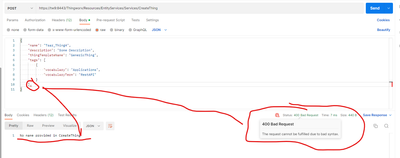

Hello Team,
Greeting of the day!
I'm trying to connect to the ThingWorx platform and make REST calls to call Services, update Properties, to make calls to REST API I m using POSTMAN. It's throwing me 400 error.
I', attaching all my details here.
http://localhost:8080/Thingworx/Resources/EntityServices/Services/CreateThing
Used the app key
Accept: application/json
content type: application/json
 "name": "SomeTestThing",
 "thingTemplateName": "GenericThing"
Kindly help me to resolve this.
Thanks in advance.
AS

It all looks correct.
Just to double-check, you're setting appKey, Content-Type and Accept in the headers and the json is in the body, right?
Are you using a custom developed app to send the request or doing it via Postman or plain curl?
I'd suggest to try first with Postman if you haven't yet.
There are a few TS articles / cases, e.g. https://www.ptc.com/en/support/article/cs341975 (issue related to  .Net SDK version) and https://www.ptc.com/en/support/article/cs343724 (issue related to incorrectly set headers)
I'd also check the logs to see the full 400 error response - additional details there can help.
Also it can be just a matter of a typo - I've attached a screenshot (0012.png) with http 400 error and the cause is just an extra comma.
I've also attached the screenshots (0011.png and 0011a.png) with correct headers and body sections, just for reference.
There are extra fields in the json body - description and tags, they're optional, having name and thingTemplateName is enough.

What's in the response body and what's the full status of the 400 error?
On the screenshot below I intentionally added extra comma to reproduce the 400 error to show where you can check it.
There also can be extra details in the `ApplicationLog.log` and `ErrorLog.log` in the `Thingworx Storage\logs` folder
