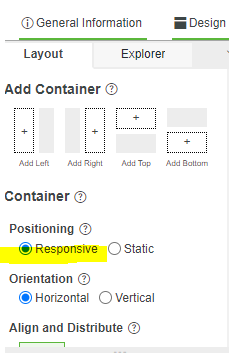

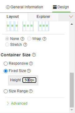

make the container fixed height
Hey Hi @GuruPrasad1 ,
Didn't get you, can you show a example ?
Shashi.
Shashi Preetham,
+91 8099838001 | shashi@psptechhub.com,
PSPTechHub  ||  World of PTC Thingworx  ||  LinkedIn
Hi Shashi,
Usually this happens when the container in which your are placing the chart is responsive, if you instead choose a fixed length and give a value say 500px this would appear better. This settings you can find in the layout tab am attching
Regards
Guruprasad S
