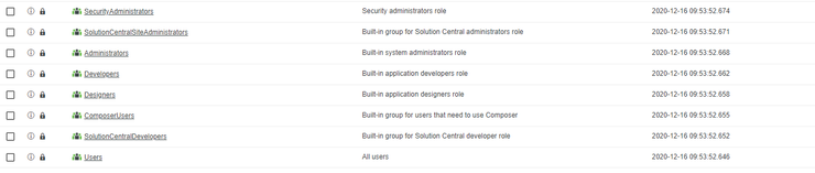

Hello everyone,
I am trying to manage visibility and permissions in Thingworx 8.5. The problem is that I want to set visibility and permissions on a certain mashup but when I go to that mashup and set the organization, when I then connect to the user who should see that mashup, he sees nothing (see the images).
In that mashup I put the organization which contain the user who must have visibility of this mashup.
But when I log with the user, the user doesn't see anything. But If the same user is included in de default group SolutionCentralDevelopers in Thingworx 8.5, the user can see the mashup.
Is it necessary to include all users in SolutionCentralDevelopers to see mashups with users who are not administrators or system users or I've done something wrong?
Thanks in advance,
Luis

Hello @LuisCabello
Do you mean the user could see the gauge mashup but cannot read the property value in it(like the first image you provided) if he is only the member of the organization? Or cannot see the guage at all?
Best Regards,
/Yoyo
April 9, 2021
Hi @yhan ,
thank you for your help. No, this is a example mashup that doesn't have data.
When I'm connect with the user, I see a blank screen. But if the user is in the group CentralSolutionDevelopers you will see the example mashup.
I only want to know if It's possible create a group of user with visibility on that mashup or if is it necesary to include users o user group into the default group CentralSolutionDevelopers for to have visibility?
If the response is that I dont need to include the user in the default group CentralSolutionDevelopers How can I see the mashup with the user?
Thank you in advanced.

Hello @LuisCabello ,
Thank you for your reply~
If the user cannot see the mashup at all, he must don't have necessary permission of PlatformSubsystem. You can refer article https://www.ptc.com/en/support/article/CS227181.
You can fulfill your business requirement by setting proper permissions of PlatformSubsystem to the user organization.
/Yoyo
