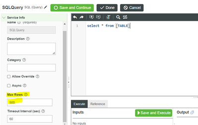

Hi Developers,
I'm seeking on how we can get over 500 records with 1 SQL query.
currently we can get maximum 500 records with 1 query.
can we make this limit bigger ?
Best answer by Sathishkumar_C
Try modify the Max Rows value in DBThing Service Info...
