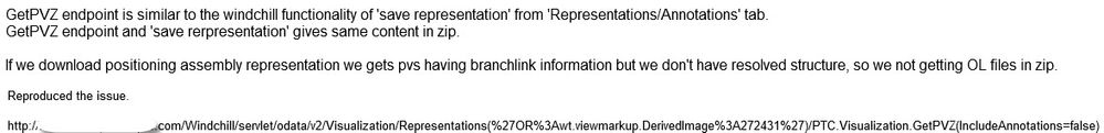

Hello, is there any method to publish a new representation of a positioning assembly via thingworx flow routine?
many thanks
Best answer by yhan
Actually, it's not an issue related to thingworx, but an issue about how to get the full content of a positioning assembly representation by using GetPVZ endpoint from Windchill PDMLink.
Suggest you raise a case/ticket to the Windchill team. By the way, after some investigation, I found below information which shows that it's a known issue and is under investigation by R&D
