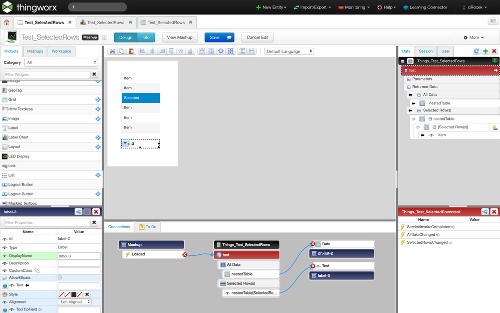

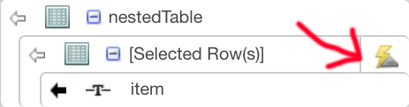

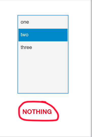

I create DATASHAPE, which contains variable (INFOTABLE) named 'nestedTable' (image 1) and have method that returns the 'nestedTable' variable with my data (image 2). I want to get data through Selected Row(s) in List and display them in Label (image 3). But i only got a blank label (image 4). It does't even react (image 5). Maybe the problem is, that i have infotable in infotable and i cannot display data from the nested infotable.

this problem is resolved in ThingWorx version 8.3.0. 👍

Has this been resolved? I also have a nested infotable. The nested Infotable values are displayed correctly in a list but I am unable to get the data from the selected row.
