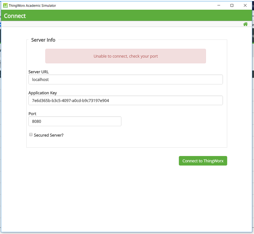

TAS unable to connect to localhost server
Hi
I'm using Thingworx with Tomcat, and I'm trying to connect Thingworx Academic Simulator but I encounter this error:
Thanks for help

I've added Group and Organization with my base user, gave them all permissions and now it works, so I guess this thread is solved

Hi @jaskulskij.
What is your ThingWorx url?
Regards.
--Sharon
Oct 4, 2019 7:17 AM UTC
I have http://localhost:8080/Thingworx, but to connect I was using "localhost".
Now my problem changed: when I use 127.0.0.1 instead of localhost it connects, Thingworx also sees a connection, but the list of Things in TAS doesn't load (it's empty). When I tried using PTC server it works just fine, but I'd rather keep using my local version.
Oct 4, 2019 9:02 AM UTC
I've just checked with Postman and it seems that I'm unable to Get any Thing from my Thingworx, maybe it's some kind of problem with permissions/location accessibility?
