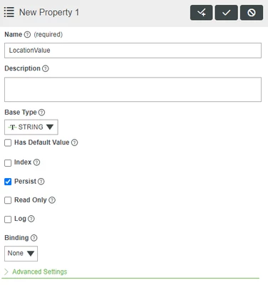

I have attached a screenshot in this post. Please have a look at it. The value of one of my property just goes away and contains no value. Its really strange behaviour. Does anyone knows whats an issue here?? It just goes away after few days and i have set it again always..
Best answer by Sathishkumar_C
Make sure the property is persistent (Persist = TRUE).
March 27, 2024
April 5, 2024
Thanks @Sathishkumar_C ! The problem is resolved.
