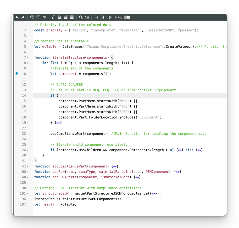

I have been trying TW10 since june but have not experienced any good usefulness with the debugger.
  1. Even though I placed several breakpoints in the code most of the time it does not break there. Is there a difference if you place them in JS functions or outside? Shouldn't be?
  2. The information shown in the Variable section is most of the time useless. It shows 'com.thingworx.types' for instance on InfoTables.
  3. 80% of our mashups are showing grids of InfoTables. These tables are populated from parsing Windchill REST services JSON data, and this would be EXTREMELY useful so use the debugger for this.

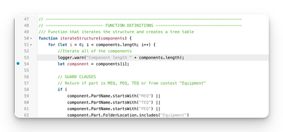

Here is one example I found for instance. This code does NOT break at the breakpoint. in fact it does not break at all going into Debug

Hi @rogerjn
What is the value of the components.length in the situation above? Another way of asking is: can you add a logger.warn just above the breakpoint (line 9) and see if it executes?
rogerjn
(To:VladimirRosu)
Hi @VladimirRosu
Yes the logger executes, but the breakpoint do not break the code.
VladimirRosu
(To:rogerjn)
Hi @rogerjn

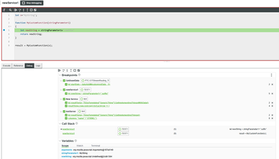

I just tested with this code and it caught the breakpoint in the function.
It seems that this part (breakpoint in function) is working correct.
Can you replicate this code below and let me know if it works on your end in 10.0.0?
I'm using an unreleased build (10.0.1) but I would like to see if this is the result of some fixes on our side, or there's something hidden.
rogerjn
(To:VladimirRosu)
Yes your short code snippet breaks at the breakpoint.

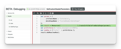

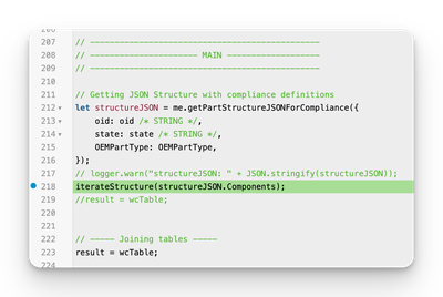

OK, so I have been testing some more. There is a common issue when fetching data. In most of our applications we are using odata cennector to fetch data from Windchill. For instance in this code the structureJSON variable is using odata-connector to supply the code with JSON data from Windchill.
If I use the breakpoint as shown, the code breaks at line 218. The iterateStructure function call then should kick in using "step into" button in debugger.
However, when doing that the UI changes to the one below. For some reason it shows the service "GetCustomHeaderParameters" on the "ptc-windchill-OData-connector" even though there are no breakpoints there, and it stays visible until code completes, even if I am stepping forward.

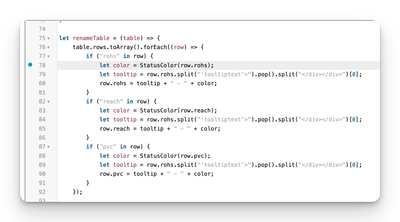

Also, I am constantly finding new issues with the debugger. If you want any feedback @VladimirRosu and get this to work before rollout you need to improve it a lot I think.
For instance this code does NOT break on the breakpoint. It just skips over.

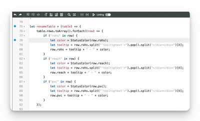

If I put a breakpoint on the arrow function startline it breaks at that line, but you CANNOT go into the function and break.
 Surely you must be able to replicate this bug??
